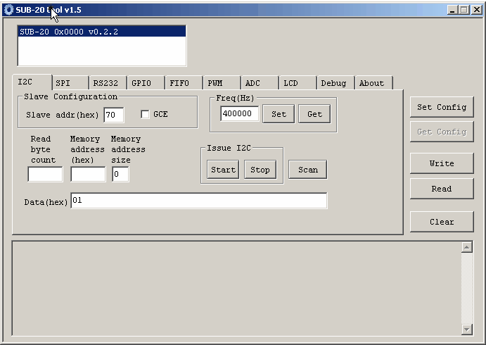

I need to test some communication between an PCA9538 I2C expander by turning on and off the I/O ports of the expander
expander adresse: 70 & 71
bit 0-4
Re: sub-20 tool manual/guide
Posted: Thu Dec 10, 2009 10:54 am
by xol
Hi,
This is what you need to do with SUB-20 Tool.
Press "Write" button to send 0x01 to PCA9538 at slave address 0x70.
