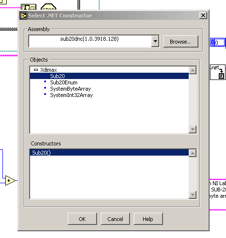

What is this "SPI" constructor? what dll is it attached to? when I add a new constructor and point to the sub20dnc.dll then I only get the objects "Sub20" "Sub20Enum" "SystemByteArray" and "SystemInt32Array".
.net constructor dialog box
Any thoughts?

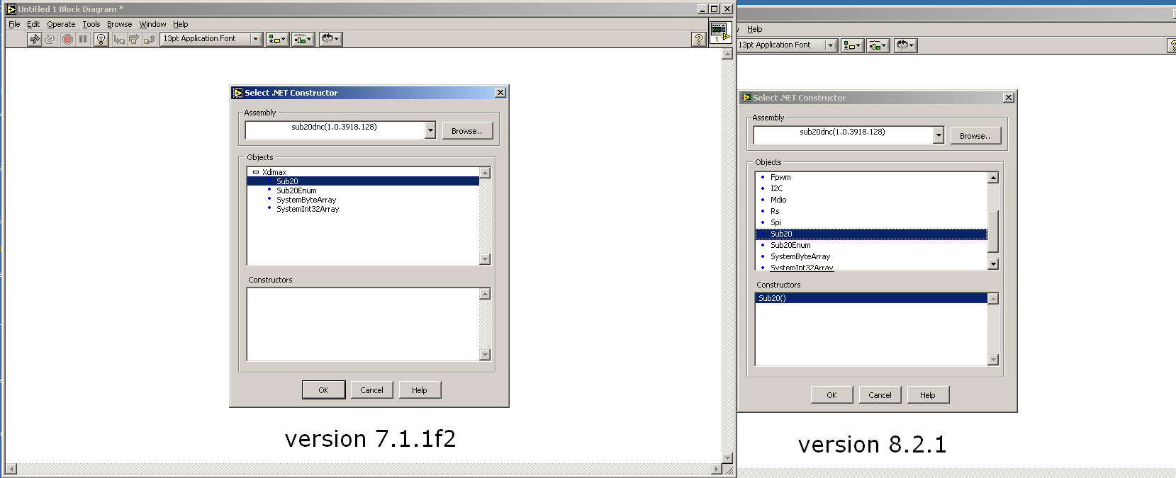

Ok I got the hardware today. I am still having problems with using the Sub20 .NET interface in LV7.1.
I started LV7.1 and created a new VI. I dropped a ".NET Constructor Node" on the wiring diagram and the constructor dialog box appeared. I navigate to sub20dnc.dll and in the "Objects" window choose the "Sub20" under "Xdimax." I push OK and the wiring diagram comes back, however the .NET constructor icon still says ".NET" instead of "Sub20." In 7.1, the available constructors are not showing. I made figure comparing the behavior of LV7.1.1f2 and 8.2.1. In 8.2.1 the Sub20() constructor appears, but it doesnt in LV 7.1.1f2.
I am able to access the class properties via the ".NET Properties Node" in LV7.1.1f2, but this doesn't get me very far.
I am able to access the constructor methods of other classes in LV7.1.1f2, I just can't access the ones for sub20.

Update. I mass compilied my LV7.1.1f2 directory and the constructor node seems to work ok now. NI recommends mass compiling the directory after upgrading to 7.1.1f2, and I had forgot to do that.
I'll post again if the problem comes back.

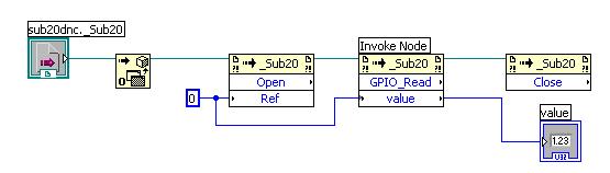

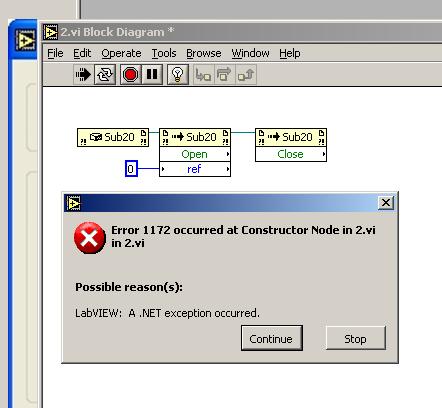

I couldn't find the LV7.1.1f2 directory. I have installed LV7.1 on XP SP2, udated to 7.1.1 and finally applied the f2 patch, however I still cannot access the .NET component. I get the following exception when I try to execute the vi
But I got the LV7.1 working with the board by using a different approach. The sub20.dnc is a dual interface module, i.e besides the .NET interface it exposes a .NET predecessor - activex interface. In order to use this interface you have to create so called type library and use this sub20dnc.tlb file as a normal activex control. See the sub20.net document for details about creating the type library. So in case you still have problems try this method. I have attached my simple vi which uses the sub20dnc as an activex control.
